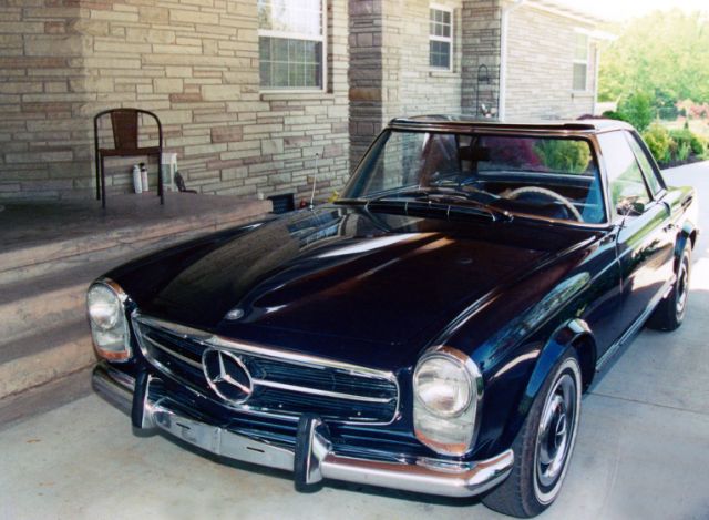

Last night I took my 1966 230SL out for a workout.  As long as I was moving the temperature stayed just above 180*+.  When I had to wait in line to get gas it started to move up to the red mark.  The thermostat was just changed and new coolant added.  Until yesterday I've not had a problem with the car wanting to run hot.  What do you think could be the problem?
