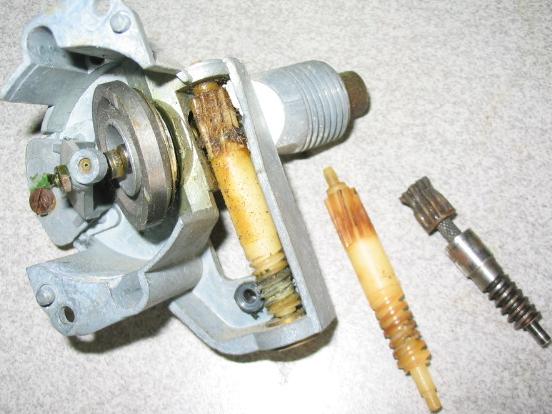

Here is a photo of the worm gear that drives the magnet for the hall effect needle...note that there are three different gears here, though not all from a 113 speedo and I assume there are others.
The metal one was in my car when I got it and the speedometer was erratic. I found the nylon gear was badly chewed and I managed to cut and slide it on it's shaft to a different part of the worm and the speedo then was steady enough to get me through the saftey check and licenced, but it read too high, I've found these other gears and more at scrap yards and I now have a speedo that is nice and steady and approx. 20% too high, so there has to be an assortment of these depending on rear end ratio....

enochbell
Re: speedometer shows 1.6 times the real speed
« Reply #27 on: July 10, 2006, 13:33:23 »
Ricardo,
Thanks for the pic of the speedo guts.  Is the worm gear driving or is it driven by the shaft?  I believe it's purpose is to drive the odometer gears, not the speedo needle/spindle?
Sorry to the board if I am getting boring with this, but it has me puzzled and I generally don't like to stay puzzled.

I must admit I have made an error here and upon reflecting on this and opening up another parts speedo, I have come to a different puzzling conclusion. Greg you are right, the pictures I showed were of the gear that drives the odo and not the speedo, and I was forgetting that when I pulled mine apart to get a steady working speedo, that the repairs I made then, weren't about the cross shaft with the nylon gears. What I discovered then was that the spinning magnet, which is directly connected to the speedo cable, plugging into the end of it, was able to move in and out from wear and this caused the speedo to fluctuate. I later repaired and replaced the nylon gear to get my odo working...memory isn't what it used to be....
I'm thinking now that the difference in speedo's for different rear ratio's may be changed by the length of the shaft to which the magnet is attached, causing the magnet to be in a slightly different position within the cup that connects to the needle itself. This cup has a sloped shoulder internally and perhaps the position of the magnet relative to the slope may influence the actual reading....??
Last night I drove the car at a steady 3000 rpm and my reading was 116 kph, (should be 105 or so with a 3.69 rear ratio and 205/70 tires) so it can't be simply k's or mph, there must be something internal to the speedo which gives the different readings depending on rear ratio and since the cable is directly connected to the spinning magnet...where else can the difference be made up???
