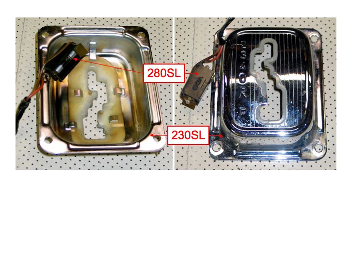

I bought a used 280SL light with wiring but cannot figure out how it is kept in place inside the 230SL shifter housing (see pic). Does anyone have a picture showing this for a 280SL, or an idea how to do this?
Download Attachment: 230SL_autoShifter.jpg
64.87 KB

Alfred,
I think the key from the previous post is:  "I don't see why you could not fit a 280SL lighted shift gate, you would just have to run the wiring."  You say that you don't have a 280SL shifter gate.

Rodd,
That is correct, I do not have the 280SL shifter box. So the challenge is, how to add the light to a 230SL box. What is difference between the two? If I have to buy a 280SL box for this then I'll probably continue to sit in the dark. :(
