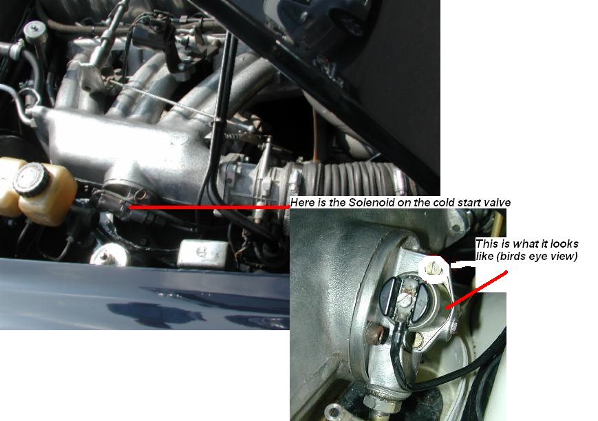

P.S: In the engine compartment where all the relays are on the left front fender, there is a relay in the earlier cars to help with starting. Is that what u are referring to?  That has nothing to do with hot starting symptons.  Anyhow just to tell you it is a black cylinderical casing.
Download Attachment: 1.jpg
67.54 KB

The photo in the prior posting is of a "Cold Start Valve" Solenoid (located at the far right of the engine compartment on the side of the intake manifold) and not the Starting Solenoid.  The Starting Solenoid is on the back of the injector pump.  Sometimes there are two solenoids on the back of the injector pump -- the Starting Solenoid is the upper one (the lower one is a Fuel Shutoff Solenoid used on USA cars starting with 1968 250SL).  Here is a photo of the injector pump, posted by Joe Alexander:

The device on the intake manifold near the intake is most often called the "starting valve". We can call it the "intake starting valve" here to prevent confusion. This device consists of a electrical solenoid and a valve which allows extra fuel to spray into the intake manifold when the engine coolant is cold. Iceberg just posted a very nice photo of the intake starting valve in another string.
