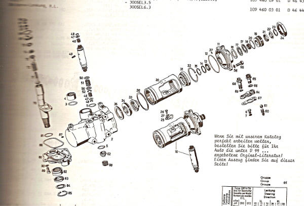

Does your car have power or manual steering? I hyave a parts breakout for both.  The power version is attached.  Let me know if you need the manual and I'll scan it.
Can you have someone turn the steering wheel back and forth while you observe the action at the pitman arm.  There is a swivel joint, almost like a universal joint, at the base of the steering shaft.  This could be the source of the problem.  There is a cover at the base which is secured to the firewall with maybe 6 bolts.  If you remove these bolts and loosen the clamp on the steering column you can inspect the u joint.

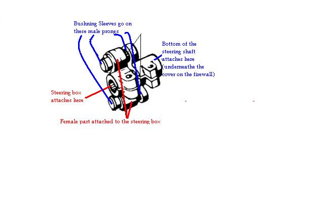

Hey Jim,
I had a similar problem with play in my steering wheel.  Ok assuming you have the same amount of play, here is what I did.  I took my steering column off by undoing the 6 bolts at the firewall.  Now where the steering shaft attaches to the steering box, it is joined by a prong with 2 male ends.  Now on these male ends there are bushings (still available from MB for about CAD$10.00).  Either these bushing are missing or have wethered away.  Replacing these are an inexpensive and safe place to begin. If this is not it, then you can go from there.  Please see pic attached where I have tried to  expalin pictorially.
Take care and let me know if this helps,
H

James,
The bushings in the "steering column to steering box" connection were worn on my car.  Actually, one was worn and one was disinigrated.  Replacing these helped a lot with the particular problem you are having.  I would not consider this a "u-joint" as it does not rotate in all directions like a u-joint in a drive shaft.  It is just a connection with a bushing.
I thought I wrote a thread about my work on this, but I can't find one.  Does this help?
