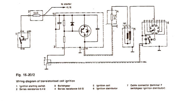

Glad you found the number.  I'm sure Rusty can help you.  Here is a pic of the ignition wiring.  The condenser is at the bottom of the page.  The dotted line is the ground shield inside the green colored wire.
Download Attachment: Condenser.jpg

I spoke with Rusty today.  None of the condensers that he has or that MB supposedly lists for my car match the condenser that is currently on the car.  The one condenser with the ground wires will physically fit.  I'm just not sure where to attach the ground wires.  I assume the one ground wire attaches to the distributer body at the condenser mounting bracket?  Does the other (distal) ground wire attach to the transistor module body or bracket?

The other end of the ground attaches to the 2 lug terminal under the battery tray.  It is right next to the ignition box.  Make sure you attach the wires to the correct lug.  See figure 15-20/2 that I attached to an earlier post.

I can't tell from figure 15-20/2 which is the correct lug.  I  assume one lug is terminal 7.  Does the ground get hooked up to the lug right next to it or does it get hooked up to the "lug" attached to the battery tray where other wires are also attached?

Both wires terminate on a the 2 lug terminal block.  One side of the terminal block goes to the ignition box and the other to ground.  The ground side wiring will terminate on a bolt or something similar which will be connected to the frame.  The other lug from the 2 connector block will go to the ignition box.  Follow the old green wire to the block under the battery.  You may want to remove the battery to see clearly.

I'm still a little confused.  Do both wires end up on the same lug of the 2 lug terminal block or does one wire go to one lug and the other wire (ground wire) go to the other adjacent lug?  Since the old condenser has no ground wire,  I can only follow one wire which goes to one of the lugs.  I hope my descriptions are not too confusing.

The wires go to different lugs.  The "inside" wire goes to the lug that ends up at terminal 7 on the ignition module.  I'm almost certain the other lug is a ground.  You can check it with an ohm meter or follow wires that are connected to it and see if they end up connected to the frame or body.
