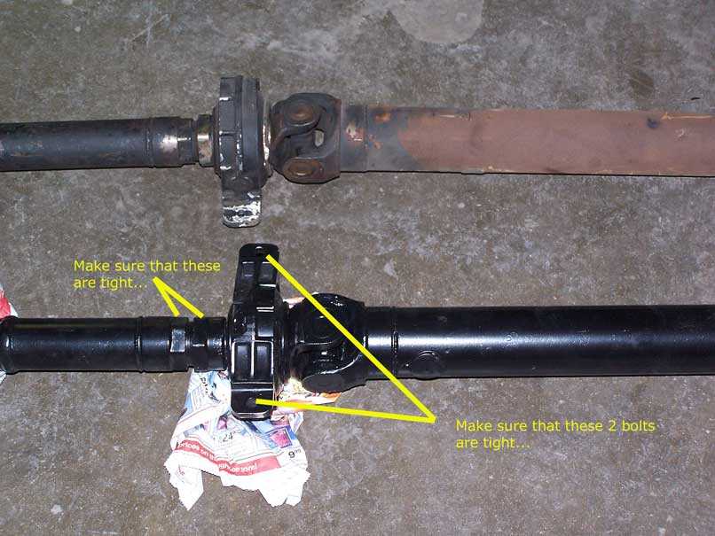

You mentioned in your post that you can move the shaft in the center...  You really shouldnt be able to move this unless you are in the process of installing it.  It needs to be tight.
Make sure the 2 bolts that hold the center brace in place are tight.  Also make sure that the driveshaft itself is tight.  You will need a 46mm and 41mm wrench for this.
Good Luck!

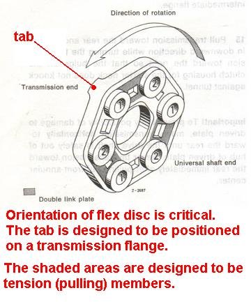

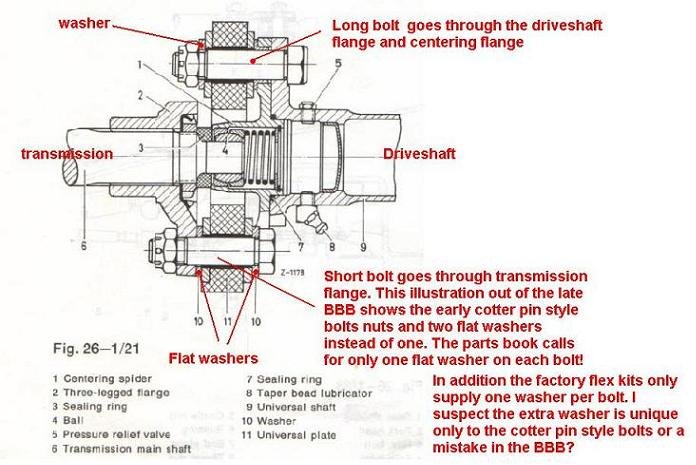

Hello Bob,
The job is fairly straight forward. Getting the complete driveshaft kit will make sure you get all the correct hardware and new nylock (locking)nuts. Installation must be done correctly or the flex disc will not last and damage to the driveshaft, or transmission may result. There is a lot of discussion on this. So do some searching.
 In short, make sure you have all the correct parts. Some bolts are longer than others and the washers must be located in the correct locations. The flex disc itself is installed in one direction and indexed with a tab (see diagrams).

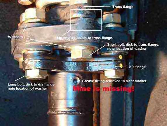

Here is Bob Possel's photo of his correctly assembled flex disc. notice the locations of the flat washers changes on the long bolts and short bolts. The flat washers are always positioned next to the rubber flex disc.
