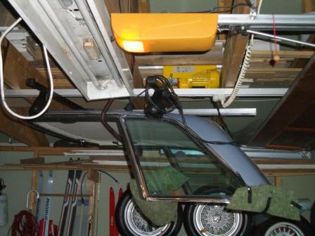

I'm using an eletric winch and a modified ski rack mounted on the hardtop. This works fine and it is also easy for me to mount / dismount the hardtop alone if needed.
The eletric winch is a "less than 100$" version made in china and for this purpose it is good enough.
