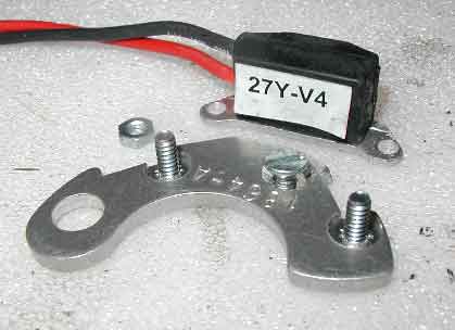

Hello Sam - - I installed a Pertronix unit in my -051 distributor. I have been very please with it so far. Consider getting their matching high performance coil as well. My engine is very fussy about spark plug heat range, so I am also running the hottest plug Bosch makes, a W9DC (non-resistor).
Good Luck, Larry in CA

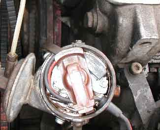

I did also install the Crane CRA700-0231 in my car - less than 2 hours using the PDF Cees mentioned - and the car started up flawless and is running very good. I bought the unit at http://www.sdpc2000.com, make a search for CRA700-0231 - quick deliver at a good price.
I have put the PDF at http://www.privatpc.no/banff/CraneXR-700InstallationTips.pdf
And pictures of the the optical unit installed:
http://www.privatpc.no/banff/Crane001.jpg -
And ready installed in car (under the battery - you have to look closely to se the ignigtion is alterd from orginal:
http://www.privatpc.no/banff/Crane005.jpg
