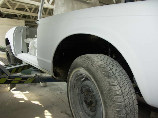

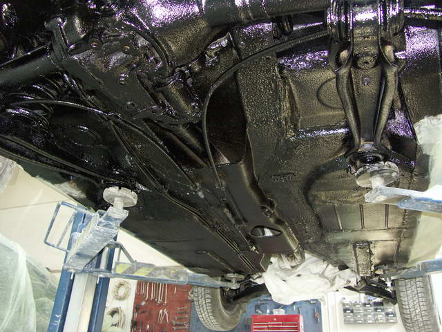

The paintjob of my pagoda is slowly finishing. The guys in the shop already painted the underside of the car. They used some anti-corrosion black grainy stuff and sprayed everything down there.
The inside of the wheelarches are now black. Should I leave it like it is or should I ask them to apply some white paint on it (the car is going to be 050 white)?
Please comment.
Download Attachment: PPICT4897_resize.JPG
44.63 KB
This is the whole picture:
Download Attachment: PPICT4861_resize.JPG
80.97 KB
P.S. The wheel is going to be white as well. [:p]

Are they painting the driveshaft and diffrential as well?  Looks like they painted everything with the pebbly undercoating.  Thought you should be aware of that.
The inside lip of the wheelarches should be body color, but spray the undercoating first then paint it body color.

I concur with Walter, although I'd probably just leave it black down there. I'd also tell them to go a little easier on that black paint. Seems a little excessive.
