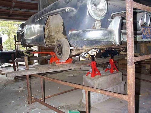

I just had to share this photo with all of you...the topic of getting the car "high enough" off the ground in order to drop the radiator made me think of it.
This is from a friend of mine, whose family used to own the Lake Minnewaska Hotel outside of New Paltz, New York, in the Catskills.  The father, since passed away a few years ago, decided to restore his 190SL when we was 89 years old.  Anyway, all by himself with just the stuff you see here he managed to get the car up as you see it.  Little bits of jacking and sticking blocks underneath repeatedly and anything is possible I suppose...
The car was never completed, and now belongs to the son.

Amazing what a little time and patience can do and at 89...but I'd like to point out that folks should not use concrete blocks.
Especially when turned on their sides like this, where they have considerably less strength.
Please use wooden blocks or even wheel rims, concrete blocks are not safe to support loads. They are meant to be cemented into a wall to attain any structural strength.
Be safe...not sorry.
