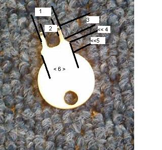

The manual antenna on my car was broken when I got it, but here is a photo of a small (28 mm x 19mm) key that I suspect may have fit it.  If it's not an antenna key, does anybody know what it might have been used for?
Download Attachment: Key.JPG
20.84 KB
Chris
Re: Hirschmann Antenna
« Reply #26 on: May 30, 2005, 12:17:03 »
I think that's an antenna key for a manual Bosch antenna, not a Hirschmann.

I have an original on my car, and a key. How is the key used?
Joe
« Reply #28 on: May 30, 2005, 21:17:34 »
There's a black plastic cap on top of the antenna. Pop off the cap and you'll see an indent for the key. You insert the key, turn it slightly, and pull up. (Or you just leave the black plastic cap on and give it a tug.)

Hey Chris,
That key looks like it will do the job.
I have added some numbers (1-6) to your picture. See the attachment.
Could you please add some dimensions corresponding to the numbers?
1. is across the outside of the pins
2. is across the inside of the pins
the others are self explanatory.
I will try to make a key to match your dimensions.
What sort of metal is it and how thick is it?
Thanks for your help

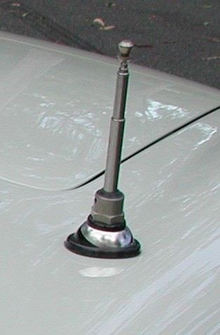

Here is a pic of my antenna folded but not stored.
Download Attachment: AntennaDown.jpg
33.32 KB

Here are the dimensions.  Numbers 3 and 4 are hard to measure exactly because the transition between them is a curve and the two sides are slightly different, as shown.  The total of these two measurements is definitely 6 mm, though.
1. 7 mm
2. 4.5 mm
3. 4.5 mm  (5 mm)
4. 1.5 mm  (1 mm)
5. 4 mm
6. 10mm
Thickness: 1 mm
Depth of the space between the prongs:  6 mm
It appears to be just a flat piece of steel. Note however that the last 1.5 mm of each prong is turned up just slightly.
Hope this helps.  Let me know if I can be of any further help.

Hey Chris,
Thanks for the dimensions. Great help
cheers
