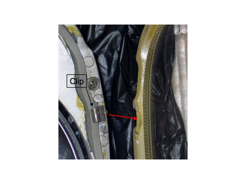

All you Euro headlight specialists out there:
What is the best way to attach the lens to the frame without breaking the glass rim  ( :(  see picture) ? Do you put the clip over the glass rim first and then push/pull the other side of the clip over the rim on the frame, or is it better in reverse?
Thanks!

Re: Euro Headlights
« Reply #6 on: March 19, 2006, 08:44:02 »
This is a tough job, I found it best to put the clip in first, then the glass, then compress (three-handed job) the seal by applying pressure on the very edge of the glass on either side of the clip, then pop the clip over the glass.  It took me an hour to do both sides, and the neighbors were wondering if I was delivering a baby.  Best of luck,

  • Posts: 5888
Re: Euro Headlights
« Reply #7 on: March 19, 2006, 10:07:39 »
I use a pair of very robust pliers to pull each clip over the glass. Takes some strength. Once you get the hang of it, each clip takes no more than a few seconds.

« Reply #8 on: March 25, 2006, 14:22:51 »
This is a tough job,...
No kidding, 'g'! Fortunately I had the old damaged glass to practice with. My final solution was to first hook the clip in place underneath and then pull it over the glass using a fishing line loop. That worked well and was quick, but only with the old gasket in  place.
With the new gasket (that was not deformed yet, see picture) I had to compress the assembly as you suggested. Since there was no 3rd hand around, I made a sandwich with 2 wood pieces, foam padding, and the headlight (without the reflector!) in the middle and compressed slowly with two carpenter clamps until the distance was short enough to pull the clips over the glass with the fishing line.
  • Posts: 4899
Re: Euro Headlights
« Reply #9 on: March 28, 2006, 21:41:45 »
I use a 90 degree "pick".  I'm assuming that's what it's called, it's like a screw driver but just has a sharp point at the end.  This particular one is bent 90 degrees (they make a variety of shapes & sizes) and is good for pulling the clips.
