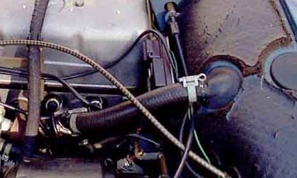

Believe it or not, my car appears to have the original heater hoses.  Typical of Mercedes hoses, they last for several years.  Now it's time to change!  The original hoses had a bumpy (or pebble like) finish.  Are there any sources of the original style hose or is smooth the only thing available today (I know this is over the top)?   The attached photo from the archives provides a reference:
Also need sources for the original type clamps.
Download Attachment: 250SL_orig_Engine2.jpg

I do not know about the hose, but I think the clamps are readily available. Actually, you buy a length of strapping material and the cotter key clamp roller. You can check the usual vendors. I inquired some time ago, and Millers had them, there are two sizes, so you can double check with them.
The "Total Restore" does an excellent job of showing you how to install these.
Pete Lesler also sells/sold these. He also has the Norma style clamps available. He had a bunch at Blacklick last year.

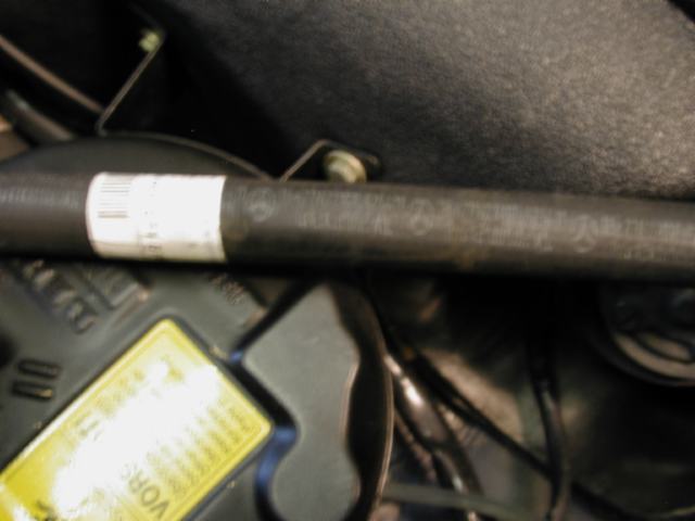

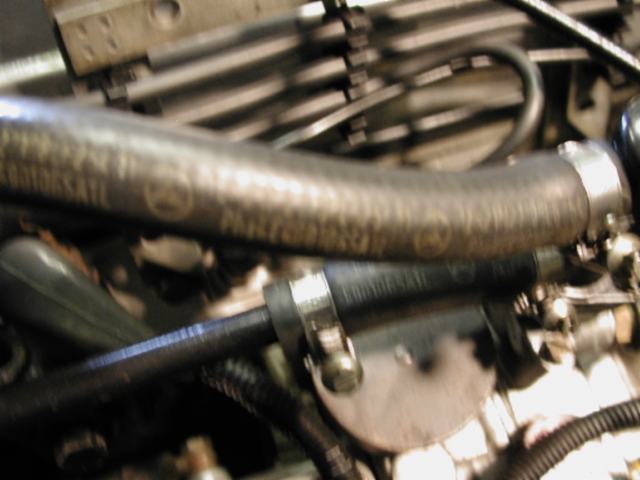

I have always purchased my hose material from the dealer.  The bumps aren't the important thing.  M-B hose will have the M-B markings.

The MB hoses are:
18mm heater: N 900281 018038 usually sold in 1m length
12mm Warming device etc: N900271 012018
If you have a shaped hose with an elbow, its a specific '113' #.
9mm hose clip band: N900263 009000 for heater hoses
9mm hose clip end: N900262 009100
5mm hose clip band:N900263 005000 for brake vacuum servo etc
5mm hose clip end: N900262 005100

Can't say what the camera was focusing on  :oops:
