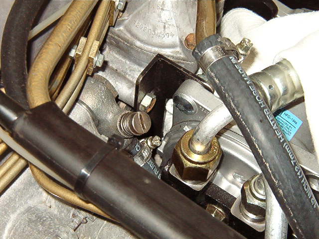

The kit included a bracket for the rear of the compressor, don't know if you have that.  It's made from a piece of 1x1 angle iron, cut to clear and drilled to match one hole on the compressor and one of the studs on the thermostat housing.  The instructions say to grind the little nipple off the t-stat housing for clearance, but it's just as easy to file the angle iron to clear.  I can photograph it if you like.
The idle air screw has to be relocated slightly, you'll see when you fit the compressor.
That's all I can think of right now.  Let me know if you'd like a photo.

The photo shows the rear compressor bracket.  I had the size wrong, it's more like 1x2 angle iron.  Slightly relocated idle air valve shown, too.  Hope this is useful.  (Note clever use of old sock to provide contrasting background!)
Download Attachment: AcRearBracket.JPG

George--thanks for the photo--that really helps. I don not have this piece but should now be able to fabricate one faily easily. the banjo bolt part is alos interesting and if possible I'd like to try this route out myself. i really don't want to cut that pipe in case I later decide I want to go bak to the ways things were. Could you tell me how you managed to drill the bolt out so precisely and then cross-drill it.

I'm glad the pic is useful.  The pipe on the banjo fitting doesn't have to be cut, the bends just have to opened up a bit to clear.  Alternatively, you might be able to notch the main mounting bracket, I didn't think of that at the time.
For drilling out the bolt a lathe was used, but I think a drill press and machinist's vise would work, too.  Lathe was useful for the spacer, too.  If these prove problematic, give me a shout and maybe I can help.
