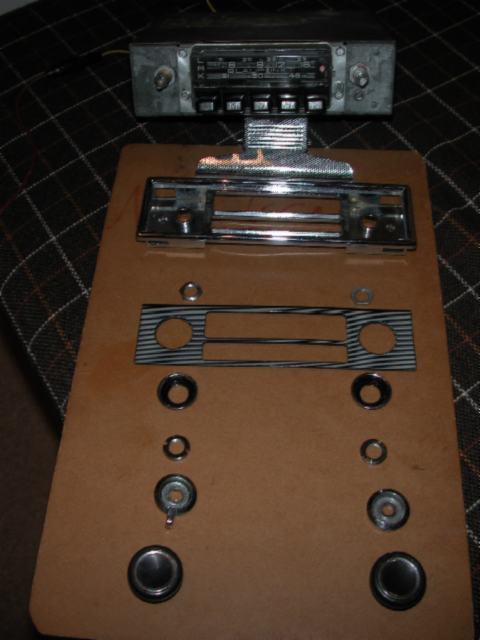

Not that simple on a 230. It takes the old style radio with a small rectangular aperture and separate holes for the two spindles which actually hold the radio to the central plate which is removable (unless its already been cut open for the din size aperture).
From what I can remember, the glove box will have to come out to remove the clock, and also the center piece of the lower padding and the thin chrome strip. A search on glove box and heater levers  will show how to remove these items.
Not sure if the radio will come out of the back of the dash once the glove box and clock are out of the way.
This picture may help: Its a Blaupunkt but I imagine the Becker is similar.
Download Attachment: Rdo02.JPG
