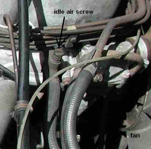

2.   The idle air valve is on the front of the intake manifold, near the thermostat housing; it’s the big, round slotted screw. DO NOT use the throttle idle stop for these adjustments.

While watching the vacuum gauge, screw the idle air valve out until the vacuum begins to fall (idle gets rough). Now screw the idle air valve in; the vacuum reading should increase for a while then begin to fall again (idle gets smoother/faster, then gets rough again). Now slowly screw the idle air valve out again until you achieve the highest vacuum reading and smoothest idle.
Note: I found that the highest vacuum reading occurred over a small range of adjustment; staying within that range, adjust for smoothest/fastest/best idle.

Hello Les,
Good deal! Everyone should ingrave these words on their garage door "check all basic tune-up settings before altering complex fuel injection settings." A simple adjustment or an inexpensive tune up part will often prevent comlex and expensive injection system repairs. Glad it worked out for you.
You can try adjusting the idle air screw to lower the rpms a bit further. This is the large slotted screw at engine (follow the small air line from the air cleaner canister to find it).
Download Attachment: idle air.JPG
28.16 KB
