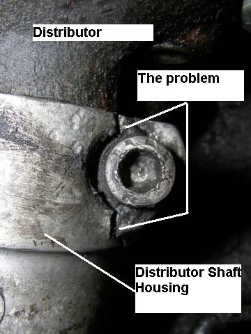

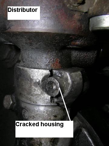

Whilst checking my timing at the weekend and discovering that it was 10 deg BTDC at 3000rpm, I sought to adjust it. Tried to get a 5mm hex key to fit the collar (see photo) but it wouldn't fit. Cleaned it up a bit and found:
1. Hex key head was rounded out.
2. There was a big crack in the shaft in which the distr sits.
See attached photos.

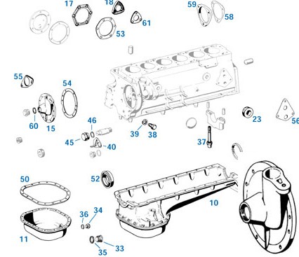

 This photo is taken from the SLS website; it is part no 15 in the photo and is listed as a 'Distr Bearing Body 280SL' (I have a 230); I have placed a blow-up of the part in the bottom right corner; note that the top of it has an odd shape nothing like the top of my housing.
Download Attachment: SLS Distr photo.jpg
39.8 KB

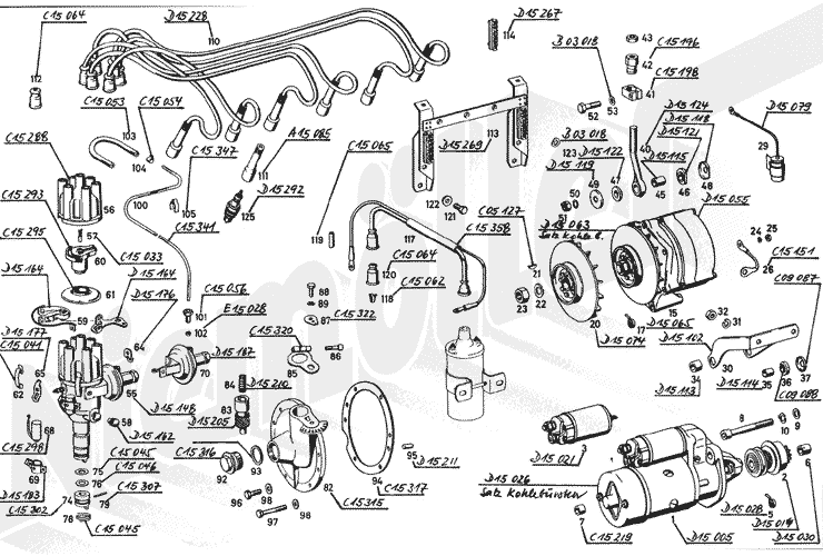

 This photo is taken from the Neimoller site. It is item no 82; it appears to be different to the SLS part, but still different to mine.
Download Attachment: Niemoller distr.gif
50.13 KB

You have the later housing that clamps the distributor. The early one is different in that it has a seperate bracket that clamps the distributor and a small lever for fine tuning. There is also one used on late 280SL's that is similar to the early system except it doesn't have a lever for fine adjustment.
The one you have is for later cars than the 113 and is very simple in design. You may have a replacement block which has this later piece as a standard part. Any of these systems will work but you have to get all the right parts. If you need to remove the front cover that the distributor sits in you will have to re - index the distributor drive gear so that the rotor will point to number one on the distributor housing.
If you can't remove the damaged clamp screw I think you will have to remove the front cover. This can be done without removing the hood or rad.

JH, Can it be welded?  Aluminum?  Weld shops have gotten pretty good on this stuff.  Not a lot of pressure on the piece.  Must have been over tightened.  ---If you can't find a replacement.
  • Posts: 7266
Re: Cracked Distributor Housing - replacement advice??
« Reply #8 on: June 05, 2007, 11:53:08 »
Nothing will fall down into the engine. All the small parts will stay in the housing.
You could get this welded but it should still be removed. I believe it's die casting. May not be that easy to weld.

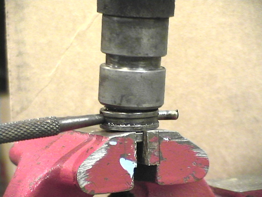

Ref the photo below, taken from the glenn-rings site coz it shows the part very well; I cannot get the roll pin out of the shaft. I've taken a large club hammer and drift to it and have given it quite a bit of welly, but it will not budge. I was thinking of putting some heat at the bottom of the shaft, but thought I'd better see if anyone has any better ideas. I don't have a press. Any advice?
Also, for the Benz Dr, if needed can you ship a distributor rebuild kit to Germany? Despite the fact Bosch claim to be German, their customer services people claim to know nothing about distributor rebuild kits or dissy parts for a 051 230SL model.

Yes I got a new repair kit from Dan a few years back, nobody over here knew what the hell I was talking about !
It tightened things up considerably and stopped my dwell shifting all over the place !
Once you have the correct pin punch and have the unit well supported the pin should push out. Mine was tight but they usually are !
