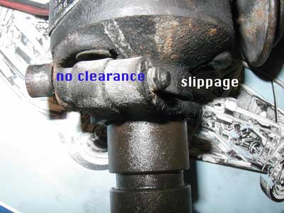

Simple answer to this perplexing dilemma:  After years of over-tightening, the distributor hold down clamp had lost its ability tightly grip the shank of the housing.  <<PIC>>  The failure occurred  when the upward force of the rotating helical gear drive overcame the ability of the clamp to resist movement, and the distributor  climbed 3mm up out of the hole and disengaged the drive keyway!  I assume this 3mm was just enough to raise the rotor's swing path high enough to contact the cap and break the end off. (still uncertain about this  last part)
One more note for those of us who think we are Hot-Shot mechanics:  While troubleshooting this ignition problem   I had intentionally backed off the clamp bolt a little so I could more easily tinker with the timing after each lap around the block. SO - - those Kraut-Gremlins then identified this as a perfect opportunity to teach me a thing-or-two.

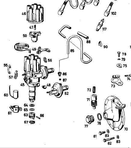

Hello Larry,
Yes these clamps cannot be left loose. In actuality there should be a small spring (#72 see diagram) under the distributor, between the distributor cog and the drive gear. This keeps the lash on the drive gear in check, but it also pushes the distributor upward if the clamp is loose!
Be careful to note that the cog (#63) on the distributor bottom is slightly off-set as is the slot in the drive gear. The cog can be forced into its slot 180 degrees off but will cause problems in the future.
Your rotor problem is probably not related to the loose clamp. The shaft inside the distributor is held down by the breaker plate and the pin through the cog and distributor shaft at the bottom of the distributor. Be certain you have the correct rotor. There are several wrong ones which almost fit but are a bit loose and will come loose and damage the cap. More often the rotor damage is accidentally caused by mis-fitting the cap or rotor.
