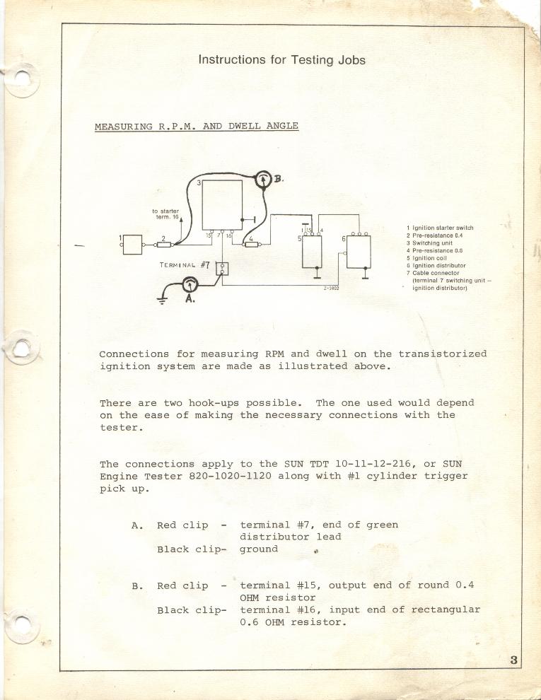

Exact hook up may vary depending on type of meter. But here are a couple of scans of original factory bulletins on the correct hook ups for dwell readings. There are two possible locations to take the reading.
Download Attachment: dwell hook up one.JPG
83.33 KB
Download Attachment: dwell hook up two.JPG
28.95 KB
