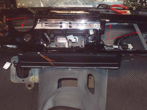

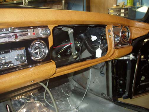

More than likely it is the liinkage,
pics for reference...
Download Attachment: P1010063.JPG
38.31 KB
Download Attachment: P1010068.JPG
26.76 KB
Download Attachment: PB180023.JPG
34.67 KB

Tom, Nice pics!
It's very possible these joints are the ones.  However they are not exposed to the elements as are the wiper shafts which protrude through the body.  These bushings and shafts are seldom lubricated and often corroded with rust.  Atleast that was the case with my car.

Thank you Tom and Jeff. This is teriffic information that should make the job a lot easier. And I agree the pictures are  great. I cant thank you enough. Pat.
