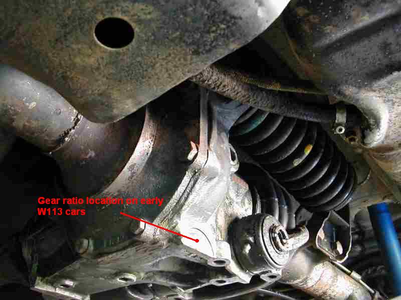

If it's like mine it will be stamped on the lower left of the central casing (looking from the rear).

Hello Kjell,
Late version W113 cars had the number on the side rib as Naj has mentioned. Earlier versions had the ratio on the rear of the casting as described by Dave. I am not sure when the change occured. Here are some photos of both.
Download Attachment: gear ratio location early.JPG

Thanks - found it. I've got a 4.08. As always - it's easy when you know!
