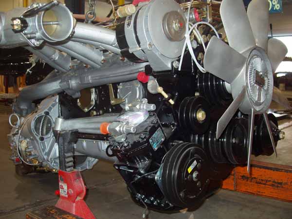

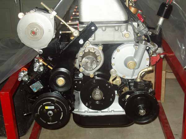

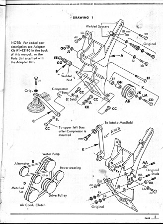

Visuals of A/C bracket on the engine, compressor and pulley setup...
Download Attachment: Install_AC-3.jpg
80.37 KB
Download Attachment: PA110077.jpg
67.15 KB
Download Attachment: PC170024.jpg
60.55 KB
