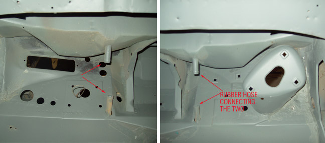

You might also check the condition of the scuttle box drain tubes.  There is a rubber hose on each side that connects the upper and lower metal pipes, and if the rubber hoses are rotten you can get a leak there that might mimic leaking wiper shafts.
Tom230sl

« Reply #5 on: October 13, 2005, 10:52:16 »
pic  showing tubes
Download Attachment: PB150044.jpg
61.01 KB

I agree w/both G and J .
 Check the drain connector hoses under the dash  [ both sides] and the body seal/washers around the spindles.  The spindles are in a body cavity so a bad washer will leak into the cabin and the hoses   commonly  dry up and crack. I replace these with clear hose so you can  easily see if they plug up with debris without having to pull anything apart at the air intake vent assembly..
..also, check the one way ball valves at the end of the drain hose pipes [ on firewall]
