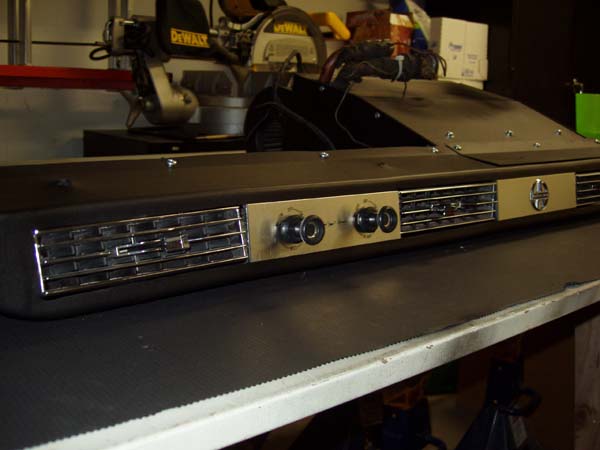

Originally posted by Kgear
Tom, that restoration looks great. Can't wait to see the finished product -- who is doing the work for you?

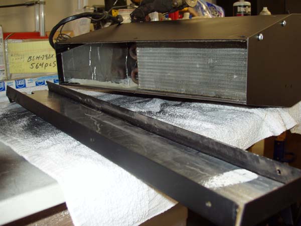

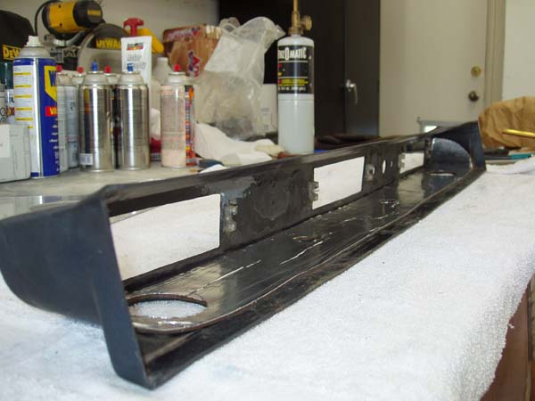

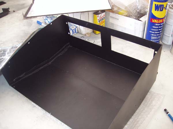

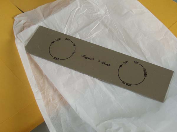

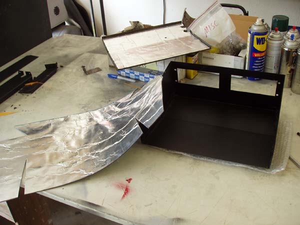

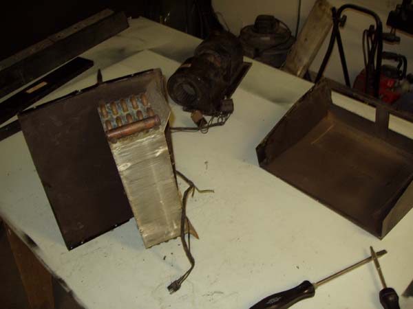

Question - can you give any details on how the A/C unit restored?  That is on my "to-do" list but I'm not sure where to begin.  My unit is out of the car but cosmentically it looks like the your "before" picture.
Ken G
1971 280 SL
Silver/red
Disassembly is pretty straight forward.  Refinish metal parts by stripping to bare metal and repaint.  Have the condenser pressure tested then cleaned and straighten the fins.  I used Dynamat inside (more effecient and cleaner than the foam rubber of the original ).  The vents were cleaned and face plates were re-created by silk screening onto new aluminum plates and water jet cutting of holes.  The plastic bezel was also cleaned and sprayed with flat black.
