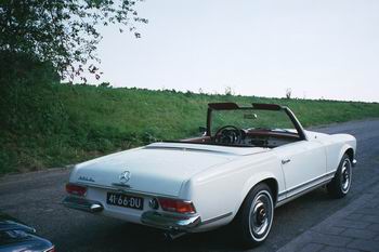

Could somebody help me out, where to start solving the problem of my shaking 250SL 1967. When not driving, the engine runs smooth with a
happy sound, without any hesitation going up in RPM's when hitting the accelerator. When driving, all occurs to be the same: a good sound, a happy engine and going up fast and joyfull. The problem starts, the moment I want to drive steady at low speed. The car starts shaking me as if it tells me: "lets accelerate man!! go!!" and after a short while I can't hold it anymore and have no other option as to accelerate or to stop. To complete this story: a mechanic told me that the injection-pump was set to idle, but he did not dare to touch the pump: it's sealed. As last: the Mercedes dealer had no clue; they just checked the Co2 and that was over 8. "to rich" they whispered, but they did not dare to touch the pump either. What now ?
