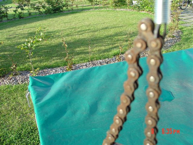

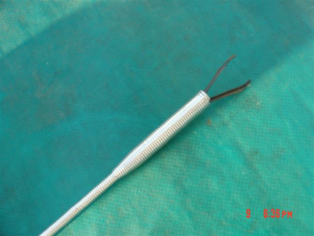

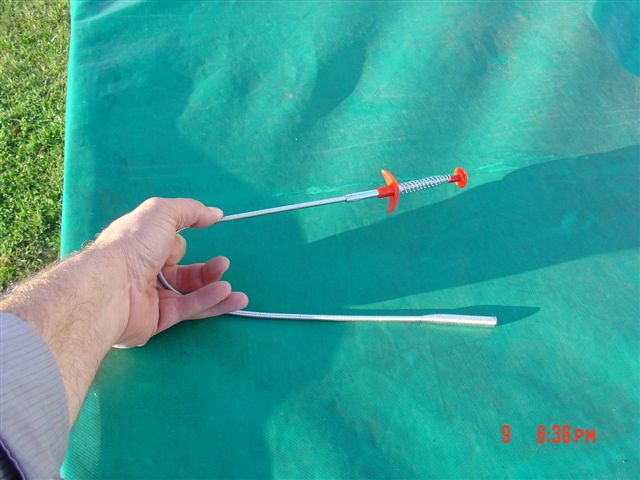

Hi Eric,
Some time ago I bought a flexible grip-thing, which I used several times to pick up lost items in the engine bay and elsewhere. It cost a few $ only and might be the solution to your problem. See attached photos. Good luck!

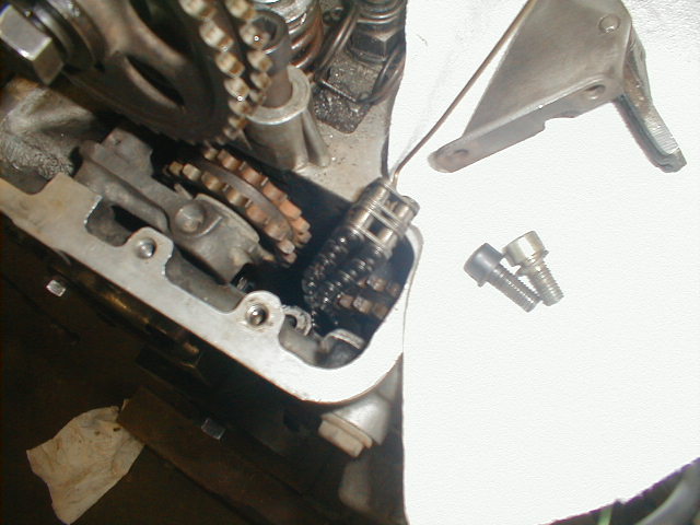

Don't panic, this is usually not a big deal, just a bump in the road! Try not to use not loose any small parts down there. You get an extra merit badge for retrieving a lost chain!
First do not turn the engine. I assume you just lost one end of the chain. Remove the top chain rail held on by two 6mm allen bolts, this will give you some room to work.

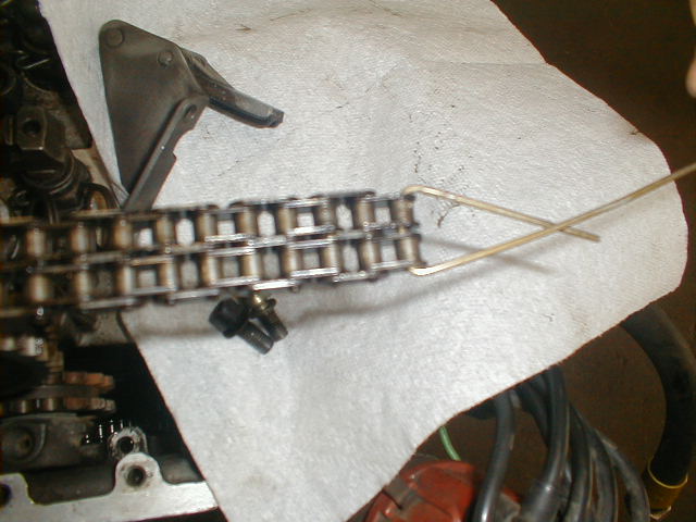

You can go fishing for the lost end next . Those suggetions for using magnetic and mechanical pick up tools are good ideas. A bent wire coat hanger works good also. Make sure you do not loose the other end.

When you retrieve the chain< wire it this way with a wire hanger, to keep it under control!

you guys are the best . I removed the guide then I used a long magnet and I was able to get to it , than I fed the new one in and all is lined up
