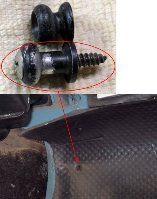

here is a picture of the studs as they were in my 230SL. They protruded through a hole in a rubberized felt mat (shown in the picture)  underneath the removable top rubber mats. The removable rubber mats have holes that are pushed over the studs to rest in the grove.  Since the holes were a bit narrower than the studs almost all were fraid by now. The studs in the upper portion of the footwell are longer and the ones on the floor next to the seat a bit shorter.  They may be different from your clips.
I was told by my carpet source that they do not reuse them when installing all carpets - and no top rubber mat - in a 230SL and I plan to do the same.
