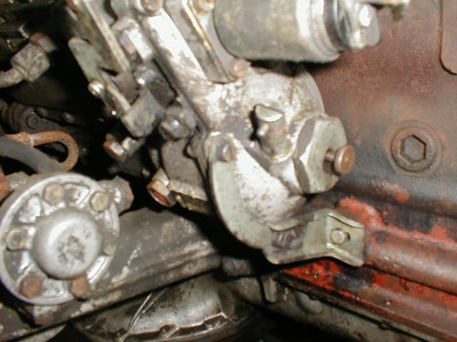

View the injection pump dip stick in this photo, it may be in slightly different places depending on the version. It is the unit with the "T" handle and large slot, it unscrews and has a dip stick attached.
Download Attachment: Injection pump dip stick.jpg
58.41 KB

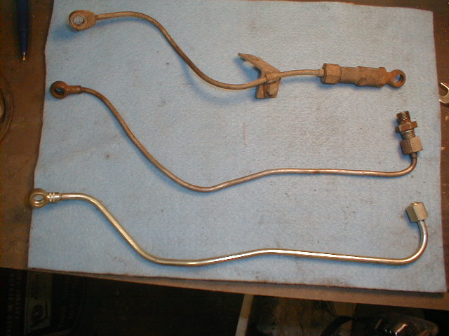

Here are three different oil supply lines used on the W113 engines. The "isolated" version uses the one with the check valve at the top.
Download Attachment: inj pump oil lines.JPG
63.75 KB
