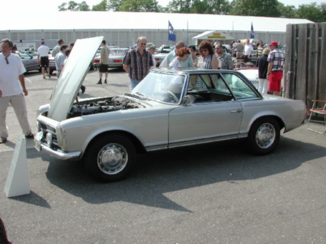

Then there was this one owner 1.2 milliom km. car at the 2003 Heidelberg gathering claimed to have original engine.
Download Attachment: 036.JPG
42.17 KB
Download Attachment: 037.JPG
47.03 KB
