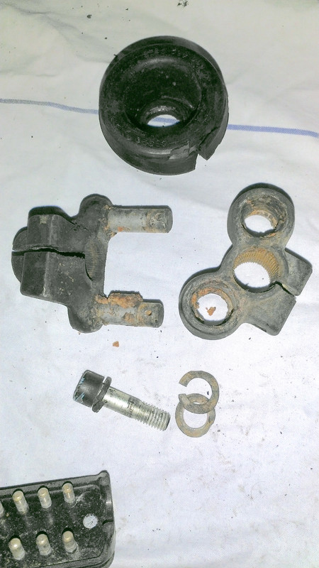

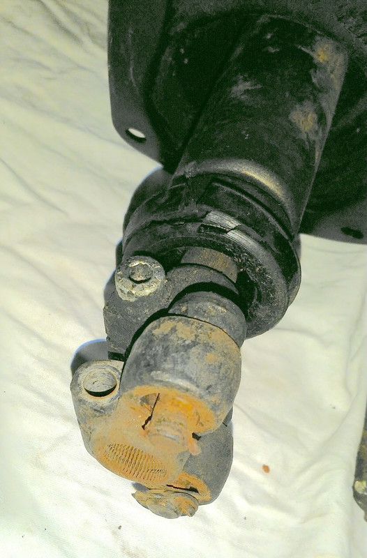

EeVeeWee
  • Posts: 401
Re: Steering Coupling Removal
« Reply #14 on: July 08, 2022, 07:07:59 »
Hopefully these pictures can help.
Again something else.
