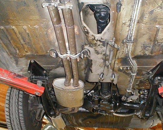

So when I understand first the floor panels were coated and later they were oversprayed in the bodycolor? And yes Kim I mean the floorpanels not the rockerpanels. But what about the attached pic of the supposedly original floorpanels' color?

The floor pans were first primed, probably when the chassis was dipped.  It is a gray-green color.  Then the plasticized undercoat was sprayed on.  It is a tan color.  The the body was painted body color.  The wheel wells got a pretty good overall coat, but the floor pans got more overspray than anything else.  If you view them from the outside they look body color.  If you view them from the center of the car, a lot of the primer or tan show through.  The driveshaft tunel, above the rear axle and any other areas that would be "shadowed" to a painter standing outside the car are almost entirely primer.
