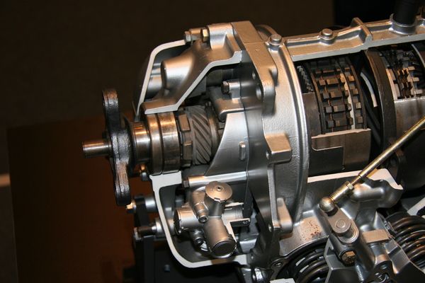

Right, that would follow symptoms... thank you. Does anyone know how to check or service this in a K4A025?
https://www.youtube.com/watch?v=UUNslRQihis
Can see it here in the cut out.
