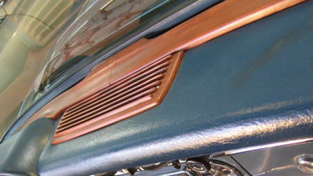

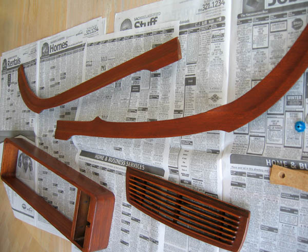

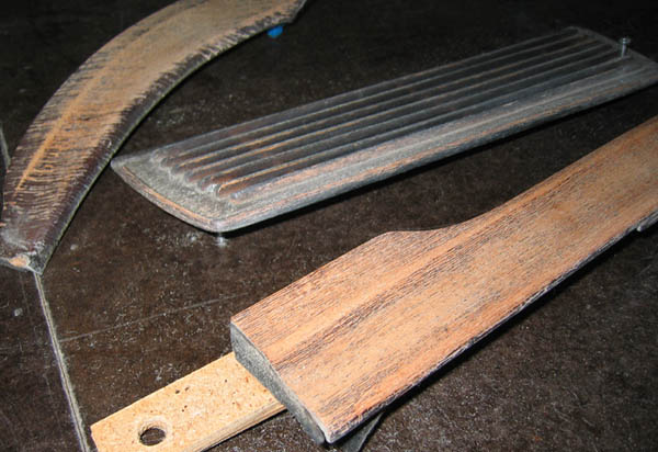

It depends on how bad the wood is.. If it needs new lamenent might be better to send out.  If wood just needs finish I would go for it.  I just did mine and it came out pretty good.... cost me about $16.
Lots of good hints on the site...Most important to remember the veneer is only 1/64th thick when new...

Dick,
How did you sand the speaker grille?  Looks like a tough job.
Re: self refinish 230 sl wood
« Reply #4 on: March 09, 2005, 17:37:39 »
First off, you don't sand the thin veneer on these pieces.  ONLY use fine steel wool and always go with the grain.  Use sandpaper and you will be sending them out to be refinished anyway, I promise.  If the wood is so far gone that you can't get a decent surface prep with just steel wool, send it out to be done professionally.
Dick M
« Reply #5 on: March 09, 2005, 18:34:44 »
Rodd...
On the dash pieces and the caddy between the seats I used #000 and #0000 steel wool and lots of time to remove the old finish.  On the Speaker grill however I used 320 and 420 wet dry with a flat stick (Popsicle like).  The grill wood was not veneer and I could be a little more aggressive removing the old finish.
Mine isn’t show quality but looks good enough for running around town...especially given it cost only $16.
