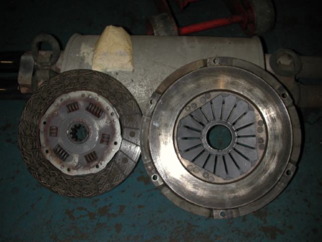

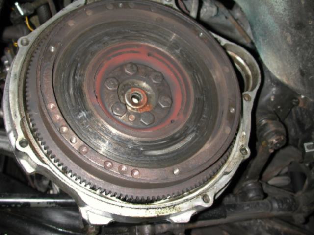

« Reply #6 on: March 08, 2005, 15:51:53 »
Doc,
Is there a rule of thumb for when the flywheel should come out for refacing?
I have some surface cracks but the scoring is not deep at all.
The clutch has been slipped at some time till the pressure plate face and diaphragm spring turned blue!
Download Attachment: Gbx002.JPG
35.97 KB
Download Attachment: Gbx008.JPG
47.41 KB
Sorry the flash is not showing up the blue or cracks very well  :evil:
« Last Edit: March 08, 2005, 15:55:47 by naj »
