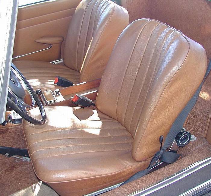

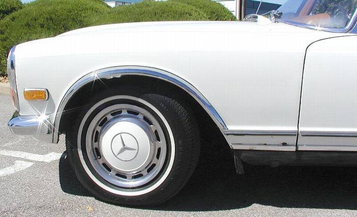

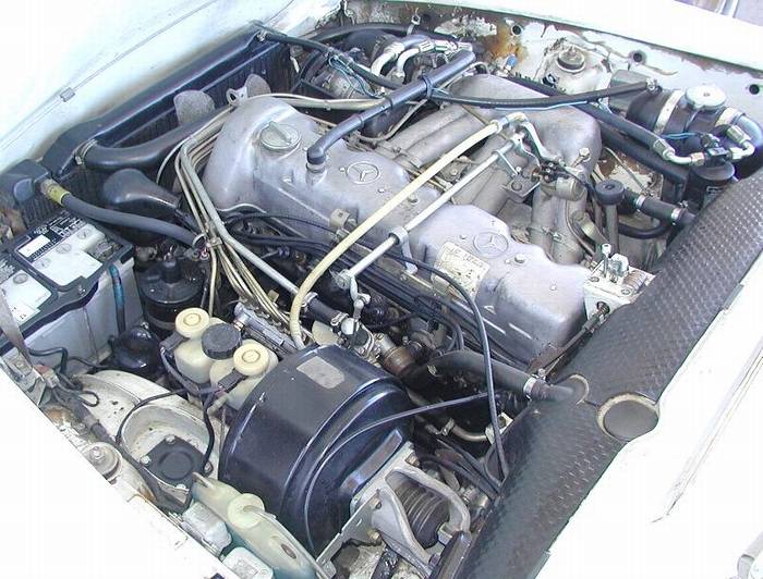

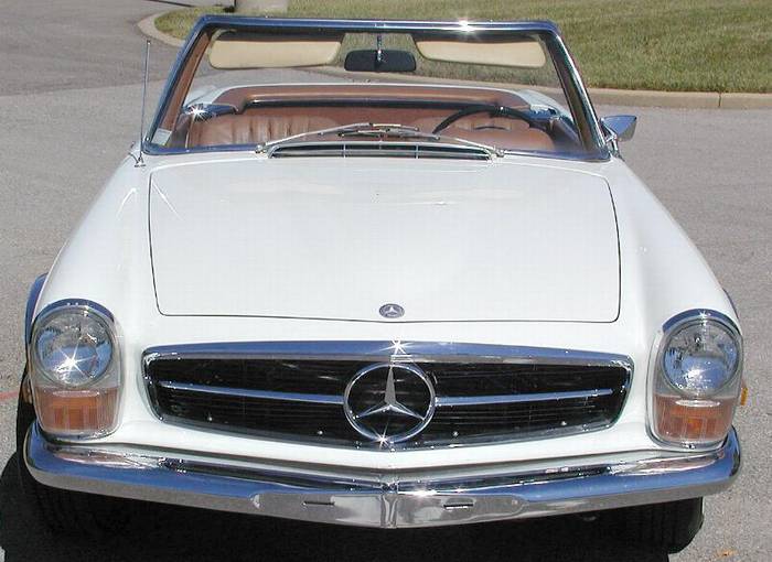

This is a 71 280sl asking for $10K. Can anyone see anything wrong in these pictures. My areas of concern: rust in engine bay and lower rocker behind front wheel well; seats not consistent with a 71 280sl; door panels not consistent with a 71 280sl.  Otherwsie it looks like a very nice car. Like to hears some comments.

It appears to be a Euro car wearing US headlights, so seats and door pockets are correct.
My guess is that it has rust hiding in it. Look at the front fender on the lower part where the aluminum trim clips in. Could just be surface rust, but I doubt it. The left headlight definitely has rust around the opening. Classic areas.
Also, the inner fenders look suspiciously discolored on the passenger side as if it's holding rust.

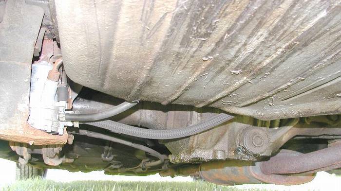

That undercarriage shot reveals nothing. The bottom of the gas tank isn't going to tell you much, though the fuel pump look nice and clean and the rear end doesn't look leaky.
Nonetheless, to me these are fairly flattering pix that aren't terribly revealing and that would concern me as a buyer.
Ask the seller to shoot pix of the trunk floor, the underside of the floors, or the area in the wheel wells just in front of the rocker panels. That'll be interesting. I'd also like to see what it looks like under the aftermarket chrome wheel arch trim.

To throw in a small positive. The firewall insulation pad appears to be in good shape, and is of the original design, proper type battery, and a few other small details underhood.

It is an odd car in that it looks like a low mileage car based on the engine area, but it has rust.
