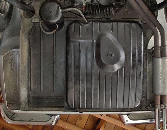

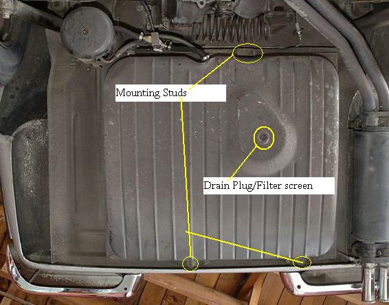

Thank you Paul, I saw these pictures:
Picture showing the smaller 65 liter tank on a late 230 SL with flat trunk floor.
Picture showing the larger 80 liter tank. Note the slightly different mounting position of the electric fuel pump
But how this is done?
A new bracket for the pump?
Do I need different hoses for this new location, or does every original part fits anyway?

Eric,
Have a look at the two pictures. This pics tell you more than a 1000 words.
The pump (or at least the pump housing, the cannister) needs to be relocated a bit in order to make space for the larger trunk.
The brackets/mounting points for the fuel tank shoud be compatible, I think.
AFAIK the hoses will also still fit - but no guarantee here.
Pls. see also the parts list.

Doesn't look to hard to move the pump.
Look how the bracket is  held on to the body and see if it just can be simply moved over, which looks to be about half a foot.
