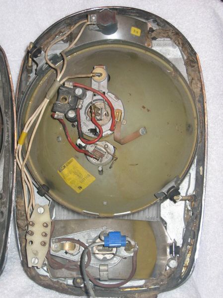

George Des,
Does your flat lens headlamp have a single or two main beam bulbs?
All Euro lights I've seen have a single (dual filament) bulb with a P43t base.
These ebay lamps have two separate (seems like) H1 bulbs. Also the red wires and the 3 pin connector seem to be non-original.

Naj,
I will try to take a picture of it and I will attempt to post it. The light I purchased has the flat lens w/ Bosch number 1305630067 on it. The main headilight appears to be two separate bulbs with spade type connectors. The parking ligt is mounted over the top of these and has a conventional bulb and connector. The fog light unit has two bulbs as well. All the lighting units have significantly diiferent connectors and wiring than the Euro units that came with the car

« Reply #11 on: January 26, 2005, 07:03:14 »
Here's the back of my headlight.  Note the connectors around the main reflector unit.
Download Attachment: IMG_1822 - Low Res.JPG
77.84 KB
Compared to this one from the eBay auction.
Download Attachment: Other reflector from eBay.jpg
57.29 KB
