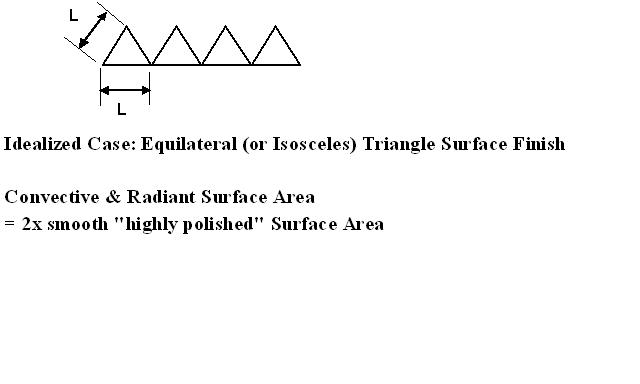

I guess I must be thick, how can it have less surface area if it's polished? surface area would not be changed by polishing or anything else for that matter unless what we're saying is polished vs unpolished areas, is that it?

The smoother the surface the less nooks and crannies it has.Polishing a surface smooths the high points of a surface so the high points become less; therefore less surface.

I thought about that but on an object as small (relatively speaking) as the valve cover that is already very smooth to begin with (at least mine is) I'm surprised that the polishing could reduce the surface area more then an insignificant amount and therefore affect its ability to cast off heat. Live and learn.

I was just making a general statement regarding what Mark had questioned about how an area could haveless surface area if polished. I agree that the surface area on the valve cover, when polished, should not change significantly enough to have any effect on the temp.

I appreciate your response and it's pretty much the answer I expected.  What you explained made perfect sense, but from a practical point of view didn't seem significant enough to make a difference in temp.

Regards cooling capacity of a smooth/polished v rough finish, the area of a rough surface is approximately 1.5x (practical) to 2x (idealized) that of a highly polished surface. See attached diagram --- an isoscelese triangle type surface finish would actually have more than 2x the surface area of a smooth (highly polished) finish in the idealized case.
Furthermore there are 2 types of heat dissipation involved... radiant and convective (i.e. air movement over surface)... in either case (rough or smooth).  However, radiant energy passing from the inside of the metal to the outside is affected by the interface between the internal volume and the external surface.  The more highly reflective the external surface, the more the heat passing from the inside to the external surface is reflected back onto itself.. and less escapes.  This is also true with highly thermally absorbant surfaces vs highly thermally reflective ones.  Thus, black bodies radiate more heat than white bodies.  That is to say that if the external surface is painted black or has a black oxide coating it will radiate more heat than the white surface.... even though the convective dissipation will be the same.
Download Attachment: Surface Area - Rough v Smooth.JPG
20.87 KB
