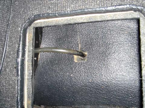

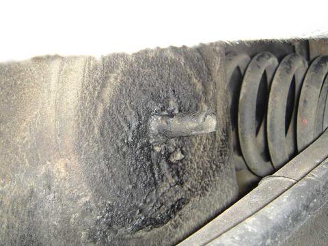

Here are photos:
Download Attachment: Rear deck drain-small.JPG
56.21 KB
Download Attachment: Under car venturi-small.JPG
34.56 KB
Download Attachment: Soft Top compartment drain-small.JPG
13.86 KB
Download Attachment: Tube2-small.JPG
33.71 KB
Re: Chin Spoiler?
« Reply #34 on: October 20, 2004, 06:02:35 »
This is very interesting to me as I live in a Country where it rains a lot, sometimes quite heavy, and water can build up and /or collect in areas you really dont want.
I had wtare getting under the seats and eventually traced it to the soft top box. I ended up sealing various areas and making tubes that go from the larger flat grommets to the sill drain holes.
Now in the 3rd photo,what exactly are we looking at, I mean I know what part of the car that is but I dont see the modification here ? Is there a larger picture available ?
Also and again on this photo there is a ridge running from just outside the area where the silver bracket bolts down, runing fore and aft, presumably to prevent any water moving accross further into the soft top box, does eveyone have this ridge ?
Also there appears to be a hole towards the front of this section, is this the mod ??

The third photo is just a reference photo of the stock drain hole that is located in the far front corner (not the rubber plug grommet). There is no modification here just a note to the other drain hole. This hole has an existing metal tube attached, and I just attached a neoprene tube to it. The tube leads down to a Y attachment that connects to the soft top rubber gasket drain hole mod.
The ridge should be stock.
.........thanks I appreciate the info and clarification !
Thing is my car does not have ANY hole in that forward corner !  I DO have the ridge but it doesn't look as well defined as the one in this picture !
Anybody else have the hole ??
'03 CLK Kompressor

If you want I can take a close up of the hole and email it to you.
The hole seems to be stock. On the back side of the hole there is a metal tube that extends down from the hole. I can’t believe that some one added this feature.
