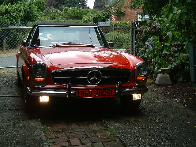

On my '69 280SL I have a small black fusebox just forward of the fuse box holder you are describing. It had a single fuse in it, only energized with the parking lights on. My friendly MB dealer told me, it was probably for the radio. I found that it was for the fogs and there was a connector inside my headlight assembly for the fogs. So I installed a pair of Bosch fog lights. Works great: Look at the picture

On my '69, that little 2-fuse holder is indeed for the radio, and the second fuse slot, unused on mine, is for the [I don't have one] power antenna.
