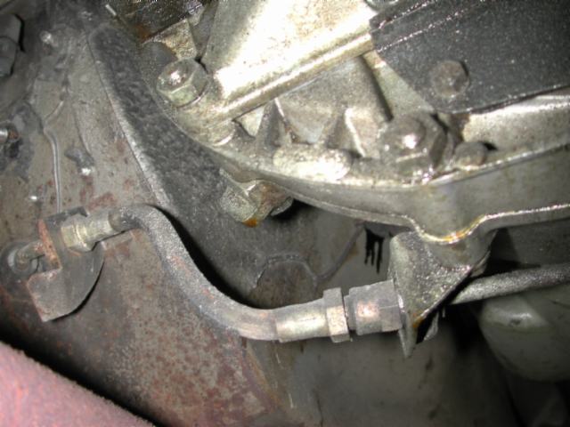

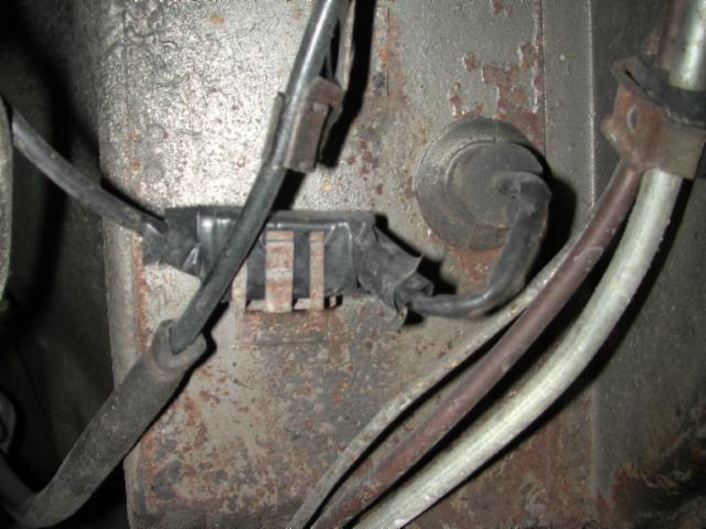

What do you make of these:
Download Attachment: UndrCarrge01.JPG
46.32 KB
Download Attachment: UndrCarrge02.jpg
48.73 KB
Yes, I do realize they need attending to  :oops:

« Reply #4 on: December 03, 2005, 13:04:10 »
Not knowing the exterior color it is hard to say.  However, in the first photo, looking up into the tunnel alongside the transmission, the gray/green I described is visible.

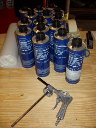

or use MBZ undercoat
Download Attachment: PB140103.JPG
67.65 KB
Vince Canepa
Re: correct color of bottom (undercarriage)
« Reply #13 on: December 05, 2005, 15:50:05 »
Just for everyone's information, how about posting the M-B part number rather than just the photo?  Not all dealer parts guys a clever enough to find this sort of "shop supply" product in the system and the P/N can be a godsend.

Tom230sl
« Reply #14 on: December 05, 2005, 16:19:09 »
will do...
000 989 20 21
