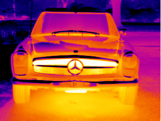

Hi Folks,
I just rebuilt my 230SL engine with new sleeves, rings and a complete head job and it has started smoking worse than before.  It seems to be coming through the valve guides, and I have seen some discussion on this.  I had heard at one point that there was a newer design seal on the 280's that was better, but I am not sure they can be retrofitted.  Also, my freshly rebuilt enging only has about 148lbs of compression.  Does this sound right?
HELP.  Thanks to all in this forum.  Here is a thermal image of my 230SL.
Allen Frechette
Download Attachment: 23sl.bmp
78.33 KB

Finally smart picture! were you using infra red film or a special digital camera??
Malc
