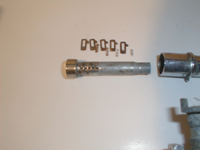

Has anyone had any luck having a locksmith re-key, say, a door lock, to accept the, say, gas cap key?

Yes you can make a key from the door handle. On the later cars with the double cut keys, a key made from the door handle will also work in the ignition. Door handles can be removed very easily without even removing the door panel as many of you know. A good locksmith almost anywhere can make the key from a door handle.

I was not talking about making a key from a door handle. I was talking about changing the innards of a door handle lock to accept a different key. If a guy's doors take different keys, is it possible to change the tumblers in one of the locks so one key will unlock both doors? This is quite easy to do to house locks, but I don't know about the MB locks.
Sorry for the confusion!

Hello again Joe,
Yes the tumblers are removable. I do this all the time on door handles, and glove box locks. They use a flat tumbler that the key fits through which is easily removable. I have an asortment from sedan parts cars which I  use to make working door handles, gas caps etc.  The finback sedan door handles are the same as early W113 cars so there are donor parts out there to practice with. The later sedans have the same tumblers for the later W113's even though the door handles are different.
The ignition switch is a different story, much more complicated, not really meant to be re-worked.
I will post some photos asap.

Hello Joe,
Here is a photo of a door handle break down. Maybe we will start a "Door Handle Tour" Topic after I get back from Starfest. Let the questions begin!
Download Attachment: P1010005.JPG

However, I think it is safe to say that the majority of us do not have an assortment of lucks from which to pluck parts! Is it likely that a locksmith will have the tumblers necessary to rekey so a lock will fit an existing key?

Here's my 2 cents, and most of you know this already: All W113 cars through 1969 had an ignition key, door / gas cap key, trunk / glove box key. The blanks and key profiles were different on the smaller keys. It wouldn't be impossible to eventually find tumblers that would fit all of the locks (except the ignition) and have only 2 keys for one car. The gas caps are nearly impossible to order by code and can't be rekeyed easily, so I would start with a gas cap key and match everything else to that. The 1970-71 280SL had one key to fit everything, plus a valet key.
