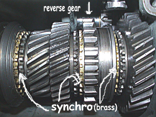

Sounds like your okay linkage wise if you can fully engage the gears while the engine is off.  You problem seams to occur when things start spinning. You may want to have a look at the fluid level and/or change the transmission fluid.  Could be a lubrication problem with the synchros.  They can get a little sticky on the gear and may not want to spin into place.
Here is a picture of a synchro.  The synchro helps gears mate. They are cone shaped and supposed to spin freely until you shift the cone shaped gear into place.
Download Attachment: sticky synchro.jpg
77.92 KB

Now that I read your email more closely I agree with graphic66.  If the car is not moving and the clutch pedal is depressed the transmission gears will not be spinning.  It appears the gears are spinning because os a clutch issue.
