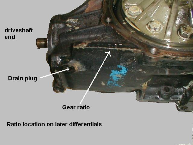

185 R14 is the the original size and therefore correct.
Do not look for a plate but for a stamped imprint on the diff housing. You may have to use sandpaper to take some surface paint of to see it. It should show "4,08" or a similar number.

Thanks for all of the very clear and informative pictures and other info.  We were looking for a plate today on the differential, and could not locate.  The car is now out of our shop, but can be put back on our lift next week and we will take another look, now that we know there is no plate.
