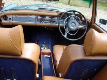

Anyway, if you're vaguely interested, here's where we ended up
Becker GP from www.koenigs-klassik.de
He also supplied the Alpine unit slung under the dash. And the 6 CD changer in the trunk. And the cabling so I can plug my MP3 in (it then sits in the tray (near the gum wrapper)).
The amp is in the trunk and that came with the car. As did the speakers. The dash one works but the two in the footwell let the rest of the system down royally. I'm on the lookout for a new pair of the same size
(and yes, I know the carpet is not standard MB stock, nor colour ;) )
Download Attachment: Radio.jpg

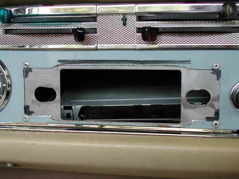

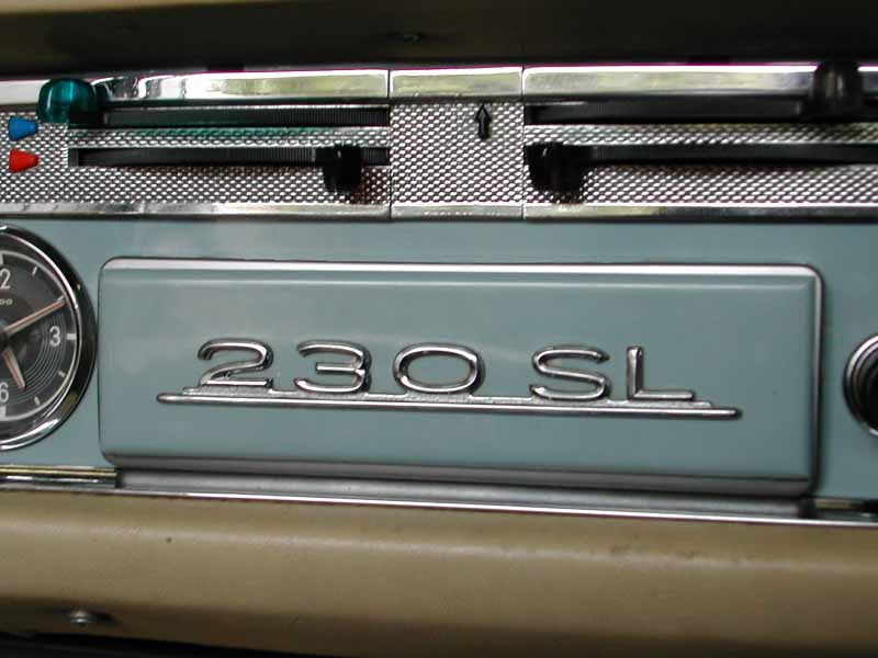

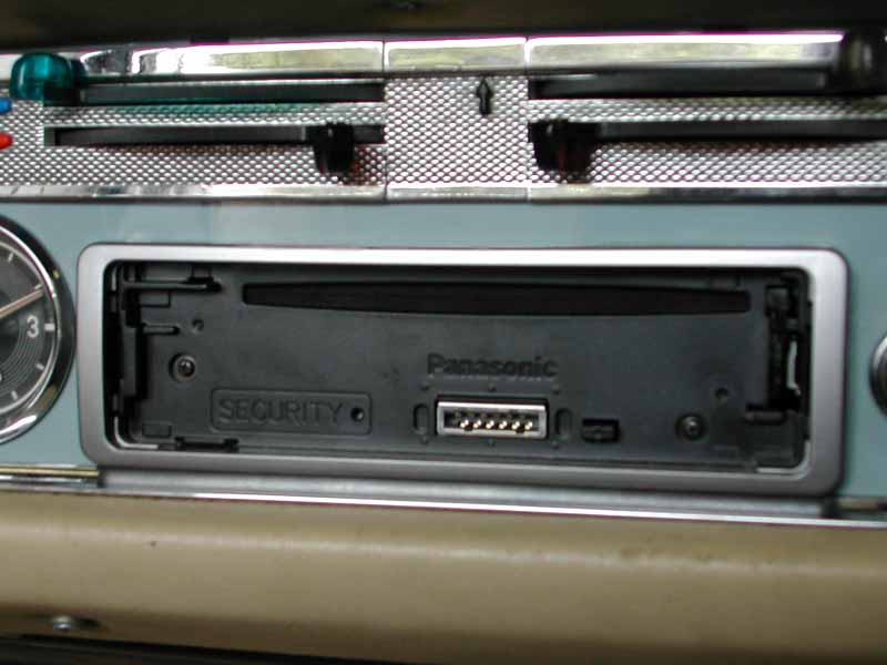

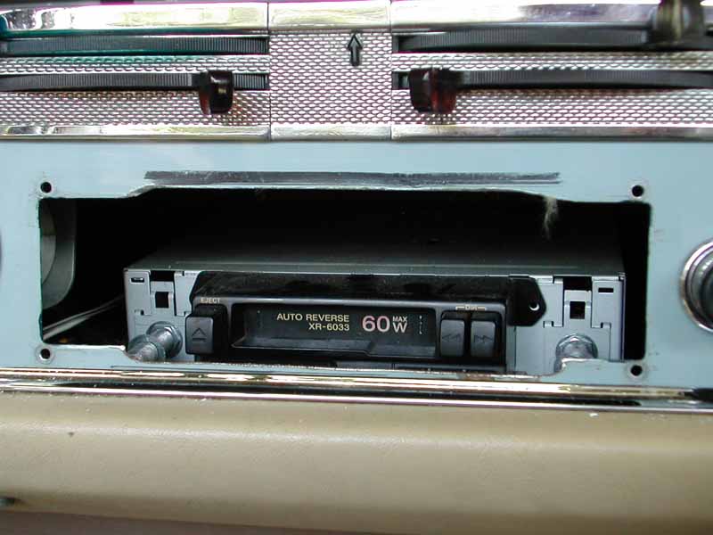

My recent experiences may be of interest to the rest of you. I just purchased a mint 2-owner unrestored '64[/b], the only downside of which was a horrible black '80s Sony Radio/Cassette unit, which I decided to remove to fit the original blanking plate that came with the car. I was horrified to find this; a cut and riveted dash!
I removed the riveted plate, after measuring the spacing of the rivets and realising that they were exactly the same as the modern DIN opening size, and carefully filed the hole to an exact and accurate DIN opening, as I had an idea.

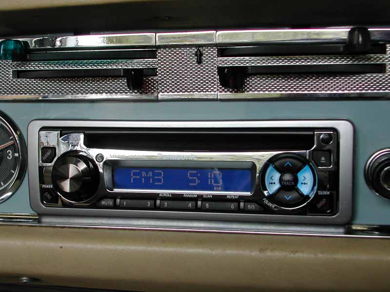

After carefully selecting a CD player with a detachable face that would look right in the dash, (ie lots of chrome to match the chrome details and at least the semblance of 'knobs' rather than all buttons) I carefully installed the new unit
With the face installed the unit looked quite good - lots of chrome and even the highlights were blue.
However, the real reasoning behind my plan was this - I carefully manufactured a fitting from aluminium to which the original blanking plate was then permanently attached. This complete 'unit' can now  simply click into place when the CD player face is removed! This literally only takes a second or so, and gives me the choice of fantastic and easily accessible stereo sound (a set of quality JL 'split' speakers with crossovers were carefully installed hidden up front) or very-near original looks with just two simple 'clicks'.
It works a treat, and the 'mounted' blanking plate actually looks so good that no-one has even picked the mounting isn't original until I point it out.

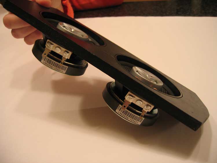

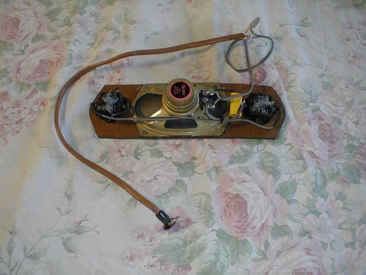

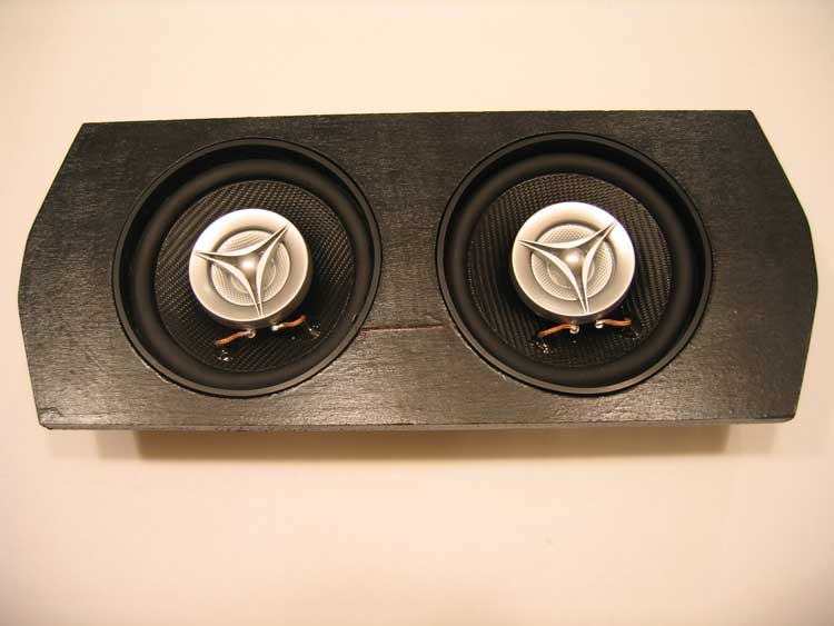

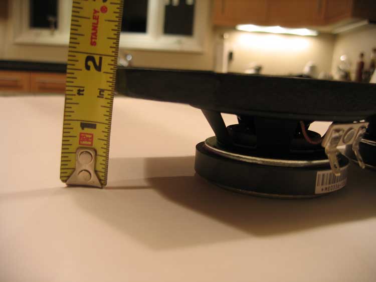

While we are back on the subject I thought I would share a project I just finished. Wanting to upgrade from a Becker AM/FM mono but retain an original look, I am purchasing a Becker Europa II Stereo. Typically, the in-dash speaker is a single mono unit. In my restoration project we found an unusual set up with a small single cone and two tiny tweeters, all set up and wired mono.

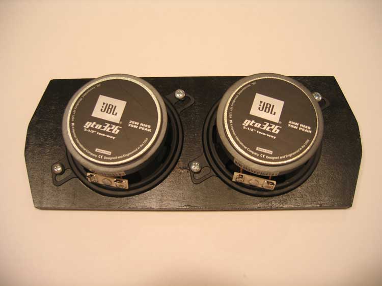

With a stereo radio in the dash, I sensed a need to have two speakers (L & R) so, after a little research to find the absolute smallest two-way speakers I could, these JBL's fit the bill. Tried to find a German speaker solution but all were larger/deeper and space is a major concern. I also considered the original MB speakers that go on the kick panels with the square black plastic covers but personally don't care for that look.
As you can see from the photos, I fashioned a 'plate' similar to the old one found in the car and mounted the two, 2-way speakers. Yeah, all of the sound comes from the same place but I've got to think this will sound alot better than mono FM playing through a single cone.
I just sent it to the guy (Brian Peters, www.motoringinvestments.com) that is restoring my car and hopefully it is going to fit. We think it will.
The final idea with regard to 'sound' in the car is to run a DIN cable from the Europa II to the ashtray. I may re-fashion the interior of the ash compartment in leather and engage a mini I-pod in there. Flip up the top and lift it out. Does that sound reasonable?
