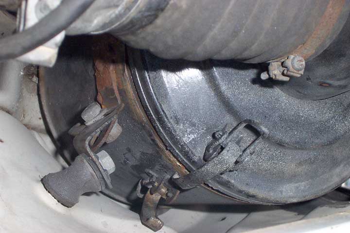

I'm moving toward the front end of my SL now, starting with the air filter (it seemed such an easy job to begin with). Well, the bottom of the air cleaner housing does not seem to match the top. Keep in mind that this car was in an accident before I bought it, so these parts may not be original despite being more than 20 years old. The problem is that the hold-down clamps on the bottom interfere with clamps on the lid that are in roughly the same spot. I'll, of course, attach a picture which I hope will illustrate what I'm talking about. There doesn't seem to be any way to rotate it.
Are these the right parts? Is this why my 20-year-old filter looks brand new?
John
Download Attachment: air_cleaner_bucket2.jpg

John,
My 1970 280SL has 2 hold down clamps mounted to the top of the air cleaner.  On the side there is a small 90 degree lip which the clamp makes contact with to secure the top.

Jeff,
Thanks. I'm thinking mine has the wrong bucket.
If that's the case, anyone have a spare they'd like to sell me?

John,
With all the significant work you're doing to your W113, don't you have an MB parts book?   :?:   I would imagine the canister and lid have MB part numbers on them that you could compare to your parts book.
Besides that, I agree that it just doesn't look right!

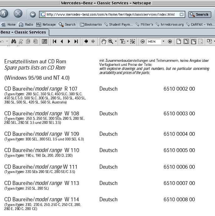

I worked my way through the German web site and finally found the 25 page list of classic service books at
http://www.cms.daimlerchrysler.com/Projects/c2c/channel/files/14625_Technische_Literatur_04_2004.pdf
The W113 parts CD is on page seven (see screen shot attached - actually, I got timed out uploading. I'll try it later.). I find the price of 48 euros, but see nothing about how to order this. Somehow I don't think my local MB dealer is going to be able to do this for me, but I could easily be wrong. Is there somewhere on the web site where you can do an on-line order.
Thanks.

Originally posted by johnlivingston
Naj,
The W113 parts CD is on page seven (see screen shot attached). I find the price of 48 euros, but see nothing about how to order this. Somehow I don't think my local MB dealer is going to be able to do this for me, but I could easily be wrong. Is there somewhere on the web site where you can do an on-line order.
Thanks.
John

Download Attachment: spare_parts_cd.jpg

Re: air cleaner conundrum
« Reply #20 on: July 15, 2004, 03:42:35 »
John,
See the little groove on top of the bucket in your picture? It should have a 'p' profile rubber seal part # 000 094 2079, sold by the metre.
