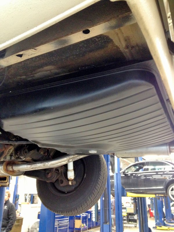

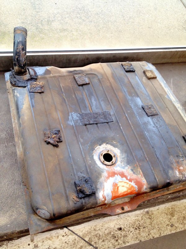

To close out this post...I took my 280SL for a drive the other day. The fuel smell was finally too much. Took a spin by the MB dealer and we put it up on the rack. My fuel tank was a complete mess. See first attached photo. I don't understand the orange patch and the goop around the filler neck...not to mention the rust around the equator. A poor attempt at a restoration from where I bought the car. I replaced the tank. See the second photo...pristine and zero smell of fuel.

  • Posts: 7508
Re: I love the smell of gasoline in the morning...my wife doesn't!
« Reply #13 on: March 04, 2013, 05:09:32 »
Looks like a bad attempt at a repair. Glad the problem is solved.
