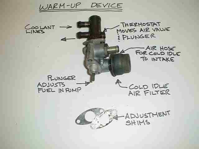

These oval shaped "adjustment shims" with three holes, when removed will lean the injection pump through the entire range of engine rpms. Start by removing a thin one first. Adding shims will richen up the engine fuel mixture. You can always put them back if the adjustment does not work. You should not have to unhook the water lines.
Download Attachment: warn up device exploded.jpg
13.01 KB
The other full range adjustment is a rack adjustment through the access screw.
